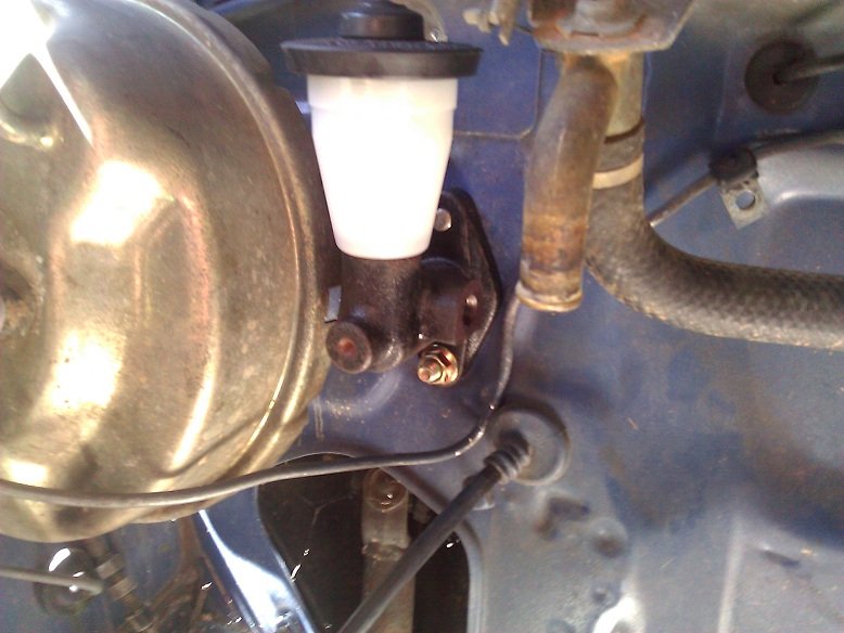

    From what I have seen, with the clutch MC mounted in the factory position (mould in firewall), the pushrod comes through 'X' amount out of line from the clutch pedal and clears cabin parts, so it can move in and out with no obstruction from anything. See below:
    The measurement 'Y' is the range needed for the clutch to work. Pretty much fully extended (clutch disengaged) to fully depressed (clutch engaged). Now, by knowing the range of the master cylinder pushrod, I can work out the position of where it has to mount to the clutch pedal so that when the pedal is depressed, the travel of the master cylinder pushrod is correct. Common sense shows that by having it mounted closer to the line of the pivot point, the travel of the pushrod will be less, and obviously making it further from the pivot point will increase travel. Find the 'sweet spot' and pushrod travel should be the same ratio to the pedal travel.

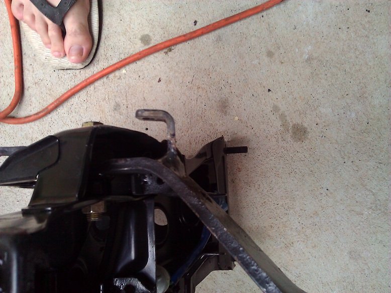

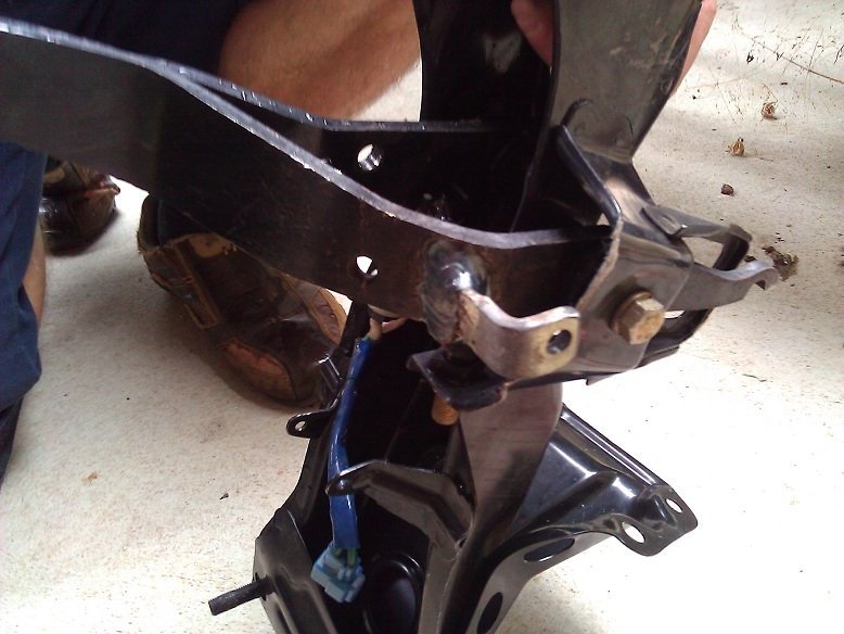

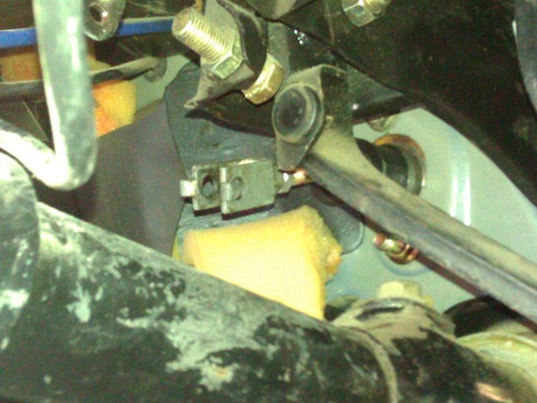

    Well, after some very fucking awkward measuring, I worked out the position of where the bracket had to be welded to the pedal.
    Tacked it on and tested it...
    ...Couldn't believe it, it actually was in the correct spot!
    Didn't worry about bracing the 'L' Bracket as I ended up rotating it 90º so that the weld runs inline with the travel of the pedal, as opposed to how I had it drawn with it being perpendicular to the pedal. Obviously time will tell, but it seems like it will hold fine.

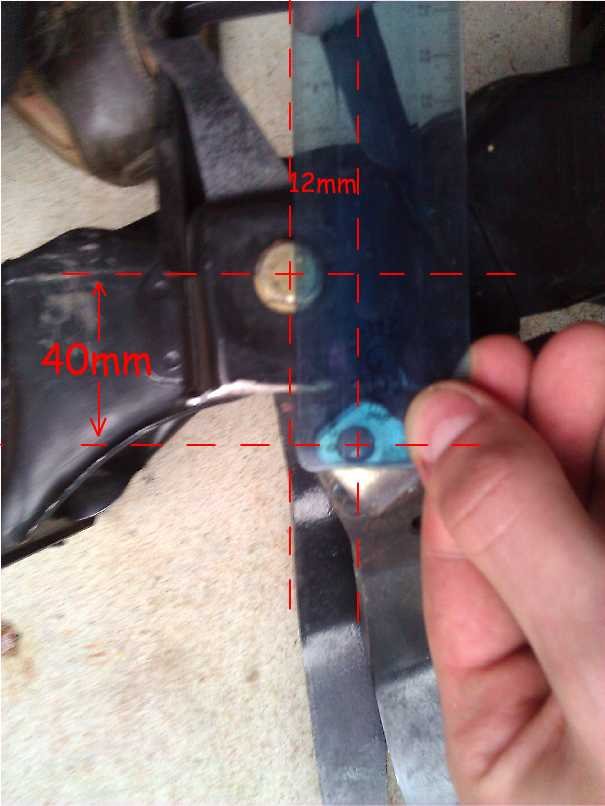

    So yeah, measurements are below for anyone who wants to try it. These were taken with the clutch pedal in the 'disengaged' position. (ie. If you had no foot on the pedal)
    And how it looks from a few angles:

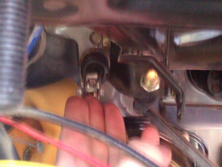

    Obviously I can't test this 100% at the moment as I don't have the T50 in yet, but I have full travel of the clutch pedal and the MC pushrod has the same travel as it did when it was in the sprinter, so theoretically it should work...
    Will see how fire wall flex goes too. That was one thing that didn't even occur to me when I did it. I have never seen an AE71 pedal box before thus didn't know it braced the firewall. If flexing is an issue, it should be a piece of piss to make a bracket that goes from the firewall behind the booster to where the clutch MC mounts. Will see how it goes first
