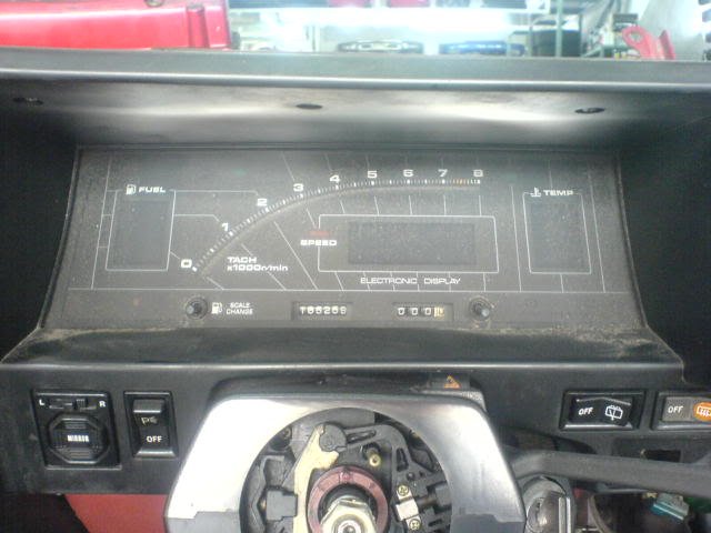

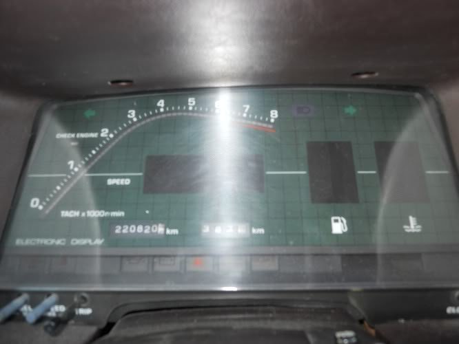

    oh really? dash looks identical, and considering same year toyota, figues it would probably be the same. found this forum topic digi dashes;
    Steve
    Cairns
    458
    I think the only similarity is they're both digital and made by toyota. I have no idea what wiring changes would be needed to make it work, but just looking at the difference in shape puts it in the "not worth it" basket for me.
    AE86 Dash
    Supra Dash
