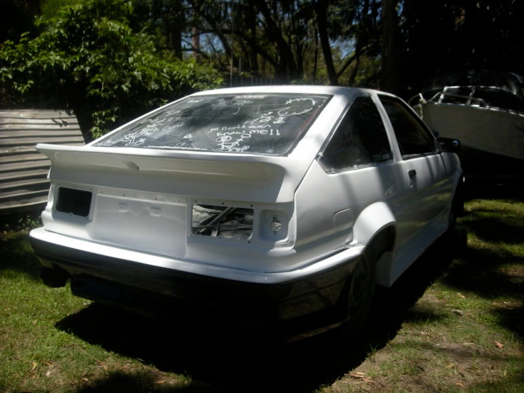

g'day all thought it was about time i put up my new 86.
specs-
adm rolling shell
brand new paint job including engine bay
smoothed out ducktail wing
smoothed out rear bolt ons
origin labs front and rear bar
origin 'stlye' skirts

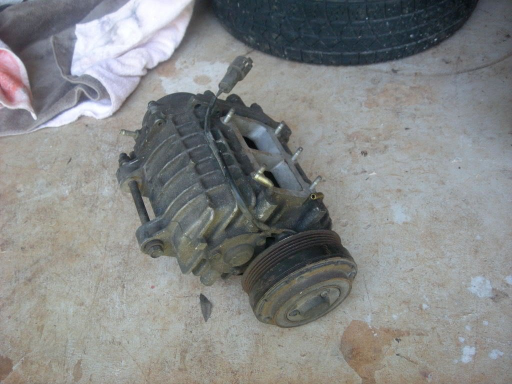

Toyota SC14 supercharger (bigger then the standard S/C, previously off a 1G-GTE)
Modified throttle body & intake set up (now suitable for a RWD applications)

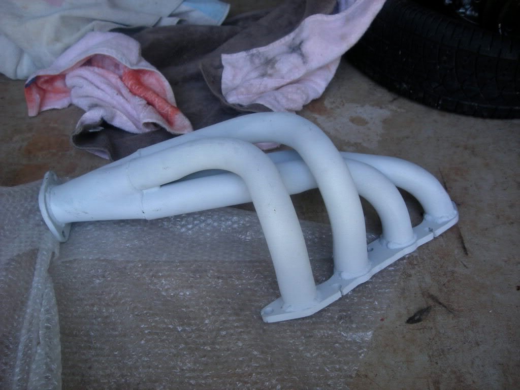

1 1/4 inch extractors coated with an extra heavy duty aluminum oxide coating (works better then heat wrapping and HPC etc)

thats how she sits right now. will be getting lower engine mounts soon so i can put the engine in and start mocking up the supercharger as i have to cut the s/c mount to clear the engine mounts.

Looks good, gze should go great with the sc14! Do you think the nevo will be a bit too big for the sc14 (ie overspin)? People seem to say never to go above 170mm on the sc14 as they dont like being spun up.

yeh i would like a drop vent bonnet but they have a really gay curve right near the fron windscreen that i hate. but we'l see. also may need to add bolt ons to the front to clear my mk3's as they are not touched at all from standard.
yeh not too sure on the pulley either. the guy i bought it off went through 5 sc14's to find one in perfect nic. ie. this one. they are pretty cheap and alot easier to get than sc12 pulley's and its not quite near the top of my list of things to do as yet.

lol looks like a 4WD or is on a jack? but fuck its looking good!
whats wrong with it? the they are quality d2 coilovers? the guy said they were sik for drifting?
nah thats how high she sits with stock suspension and no weight in it at all. nice wheel fitment too lol
