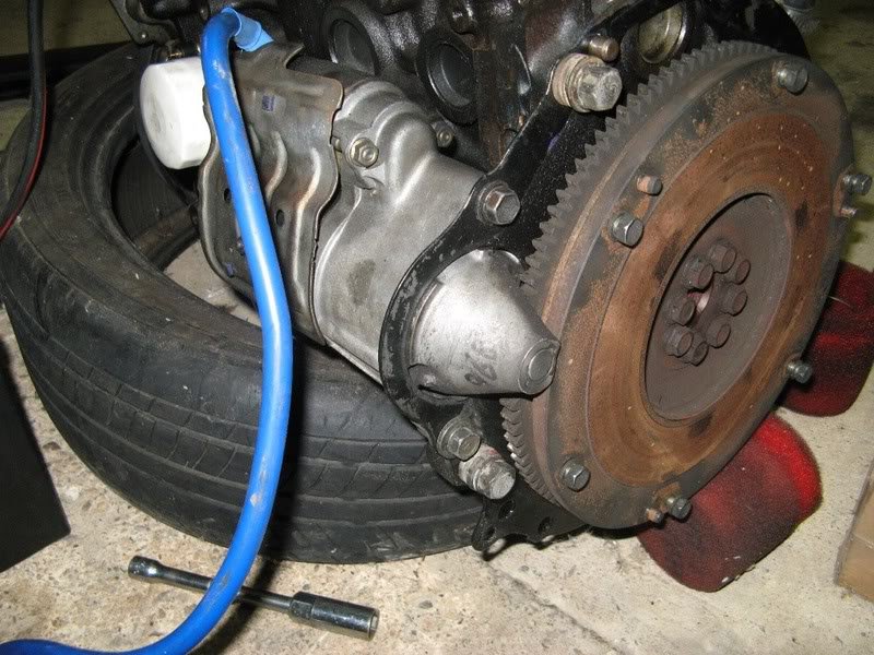

first bolt the starter up to the engine using 2 short 14mm bolts, install 2 more 17mm short bolts into the sandwich plate to ensure the starter has a good solid mounting. you can see what i mean in the pic below

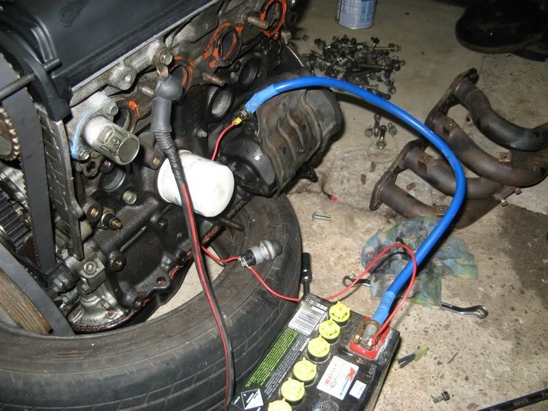

now the stater is connected we need to build the start circuit
1. bolt the earth strap to the block/head
2. using a female spade terminal join one of the two thin wires to the starter solenoid spade terminal
3. join the other end to one terminal of your switch (i used a push button switch)
4. attach the other thin gauge wire to the remaining switch terminal
5. attach the heavy gauge positive cable to the large fitting on the starter
6. now attach both the positive and negative cables to the battery and touch the thin wire on to the positive terminal (to ensure the switch is not already on)
should look like this (ish)
now you can test the circuit
i braced the engine with one hand and pressed the starter button with the other, pressing the switch causes power to trigger the starter solenoid which will the close the start circuit allowing battery voltage to travel to the starter and turn over the engine.
if that is working as it should you can now fit the compression tester and test each cylinder!!

Had my current ge tested exactly like this too, works like a charm. The sandwich plate does not flex at all really onces it's cranking![]()
