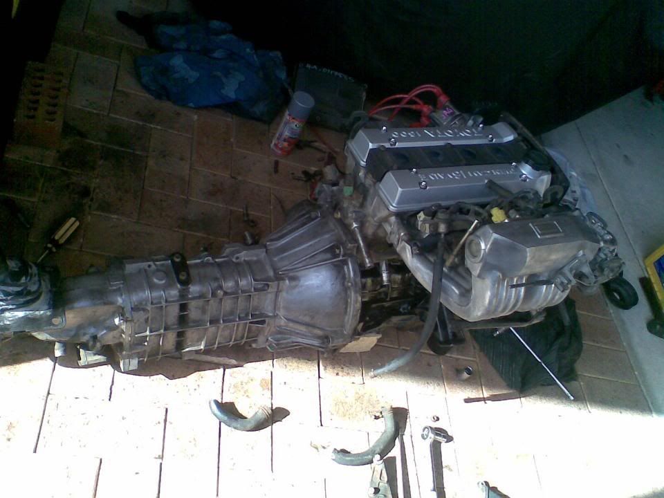

    Veteran Nikkojoe's Avatar
    Tom
    2,260
    cheers so in this pic below its the brown plug?
    Yeah brown sensor is cold start timer. No STJ signal back to ecu though.
