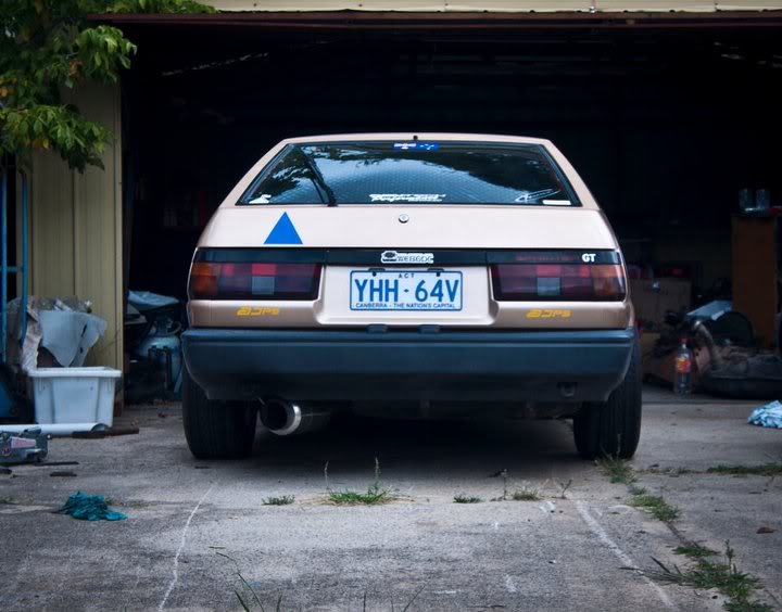

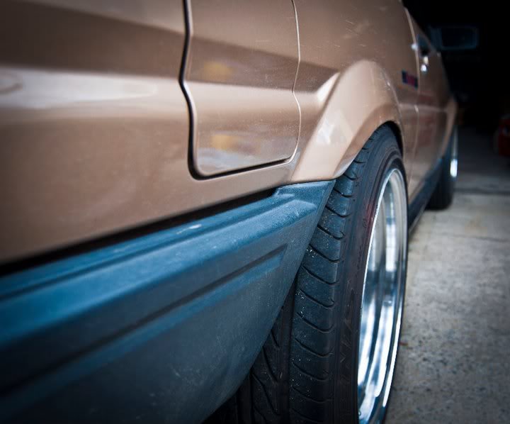

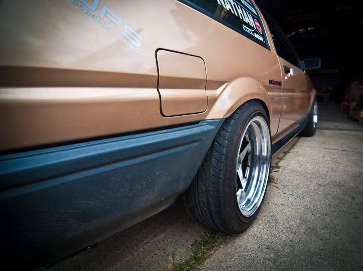

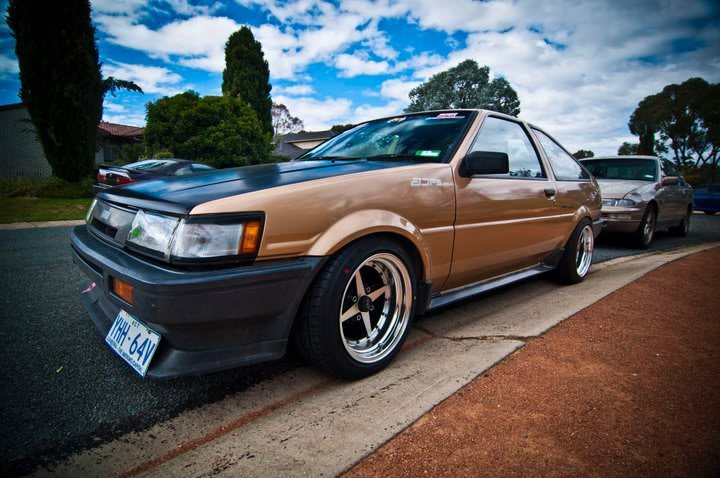

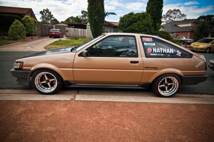

    Just got my Equip 01's on my AE86 this week.
    WHEELS: Work Equip 01's
    SIZE AND OFFSETS: Front - 15x8 -3 offset
    Rear - 15x8 -13 offset
    GUARDWORK - Lip'd and slight flare with a guard roller
    SUSPENSION - Adjustable height coilovers at all 4 corners (GREDDY kit) 8kg Front/6kg rear, Standard LCA's
    FRONT ALIGNMENT - Camber -2
    Castor +4
    Toe 0
    Wheels dont scrub at this height, but my suspension is fairly stiff with my setup. The front could actually easily go lower, just haven't had the time for optimal adjustment this weekend. Can only run 195's/50's or less, other wise scrubbing/fucking guards will occur

    do the wheels touch the front bumper?
    Veteran maxhag's Avatar
    JoJo
    ACT
    Tuggeranong
    2,786
    Not now. When I first got the alignment with MAX castor (+6) it did. Got it moved back to +4 and its fine now....

    Mine sits very close to Maxhag's rears (15x8 -15) but have slightly more tyre detail scrubbing.
    McLevin, if you want to try (testfit) the above wheels, PM me, see if you like the size and offset, and get an idea that way.
    Maxhag, is that with rear adjustable panhard rod installed?
    Big up's for the North East Massiv'
    NSATB - New Skids Around The Block
    JoJo
    ACT
    Tuggeranong
    2,786
    Yeah, whiteline adjustable rod..... Might mention that I have an R31 rear diff housing etc, which has been slightly shortend, that said, it would make the track differant to people with a T series...
