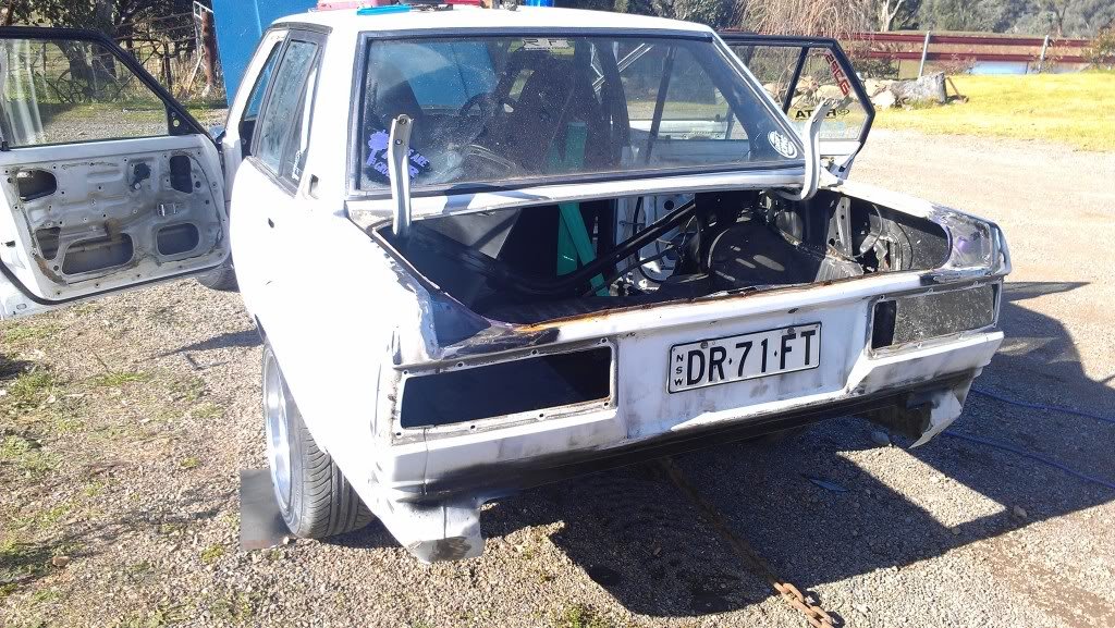

got heaps done today. cut a sqaure out of the boot and went back inside to the heater lol
And yes that is vice grips you see being used as battery terminals lol don't bag it, it's the new thing at the moment.

quality build mate!! Lovin It!
Thanks mate!

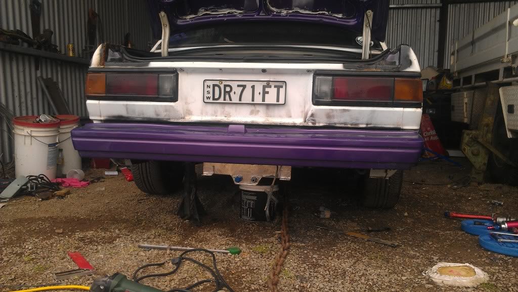

started stripping the car ready for panel and paint, stripped all the factory loom out, got rid of the ignition barrel and stalk, shortened the steering collum, made up a cap and a smaller bearing bearing in the top of it..
so many things to do to the car so i need to get at least one thing finished, paint it is!
