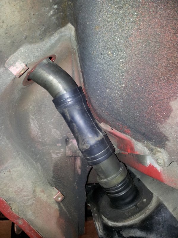

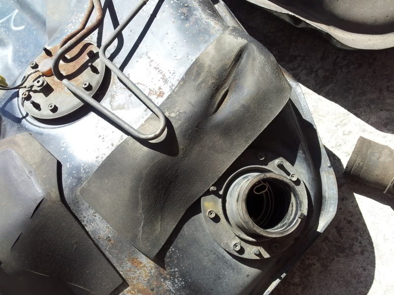

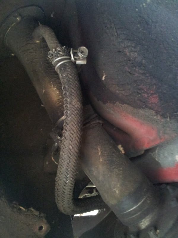

This is the AE71 stock fuel filler neck setup. It has a return hose to stop fuel overflow.

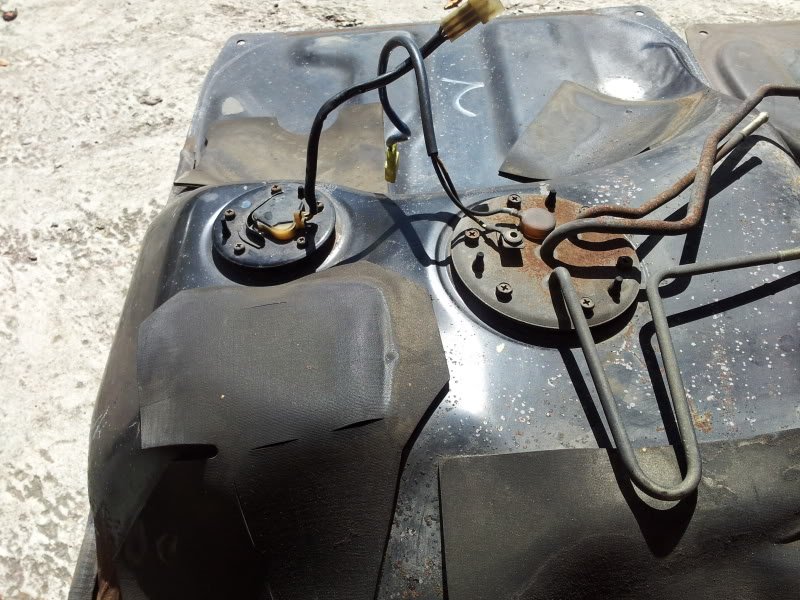

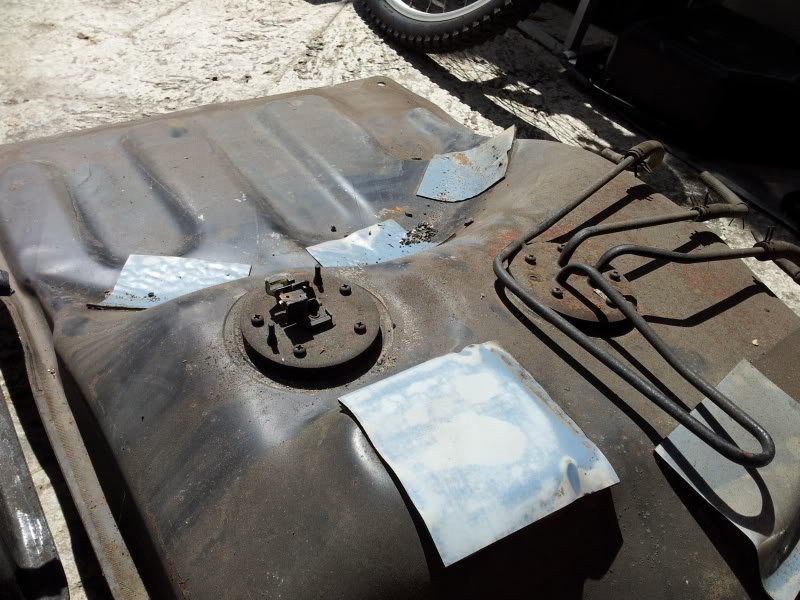

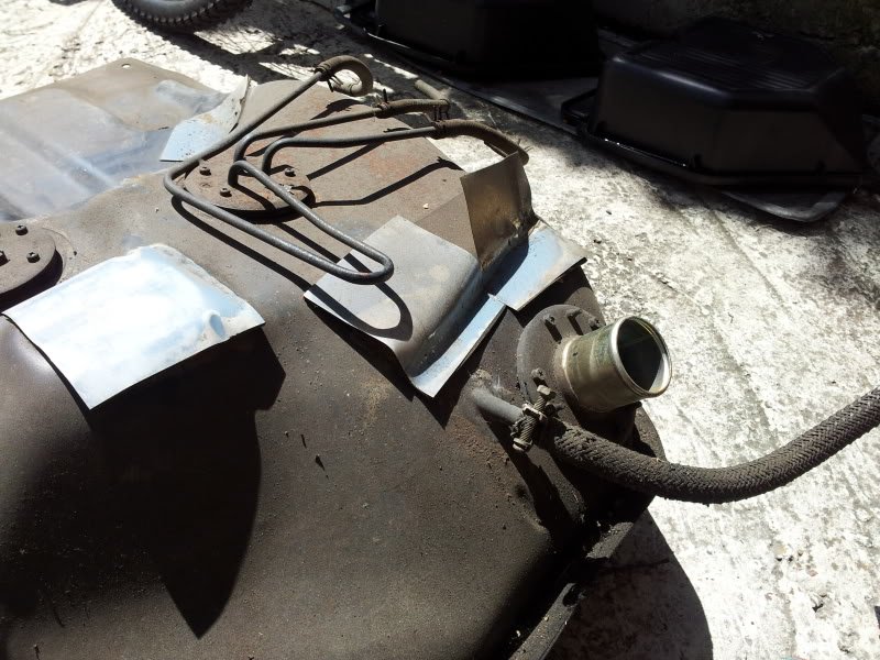

I then removed the tank and this is them side by side. JDM AE86 EFI vs AE71 on right. You can see how the inlet connection differs between the two in location and type.
AE71
AE86

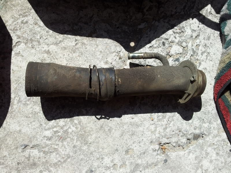

This is the removed AE71 filler neck. It uses a hose connection and is the same as KE70. We need to keep this hose to use in the modified AE86 filler neck

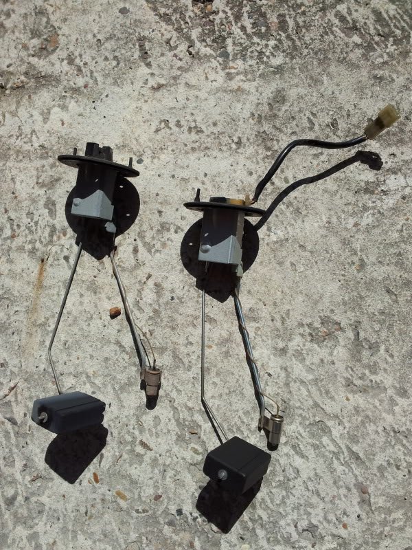

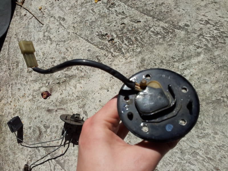

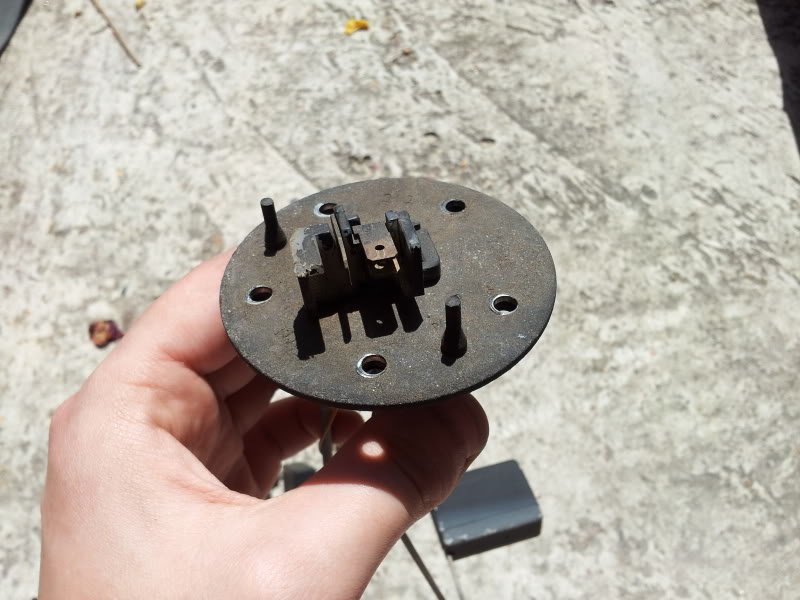

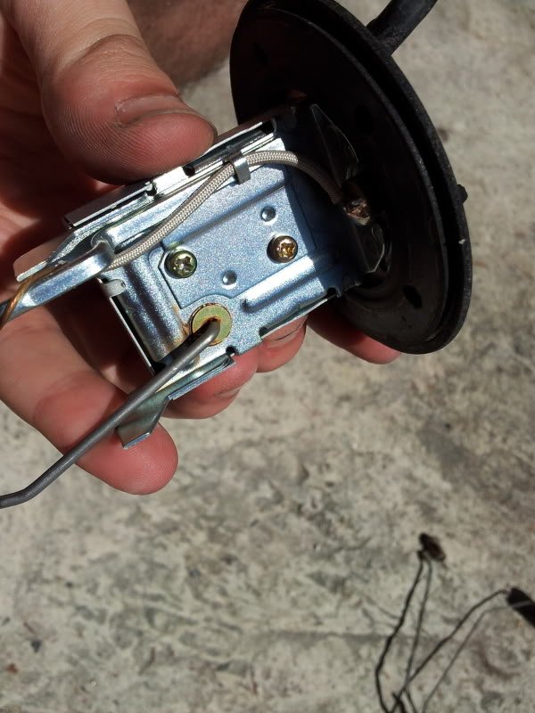

AE71 + AE86 fuel senders. Pretty much exactly the same although the AE86 uses a plug.

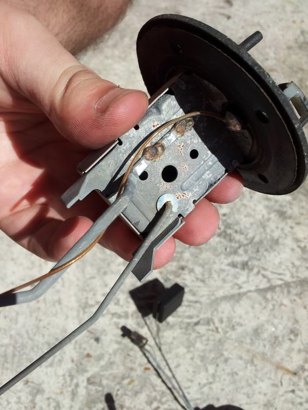

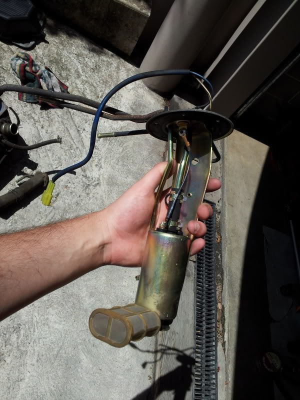

This is the AE86 intank lifter
