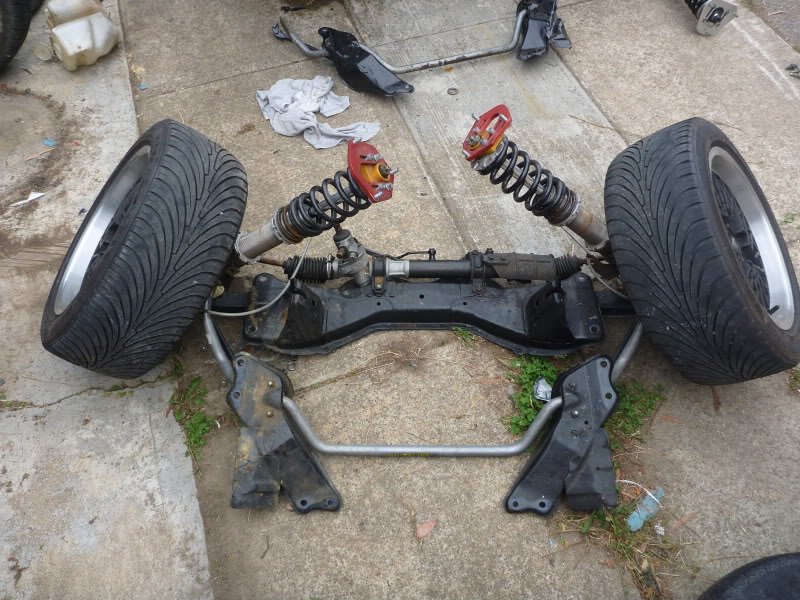

    Day 1:
    First was to seal the car up. Time to raid my AE86 parts stash!!!!!!!!
    I picked my best pair of side mirrors and ADM tailights, and fitted them both up. Looking good already
    I started by pulling the whole Nissan frontend out. I dropped it all down, and wheeled the dirty Nissan parts away

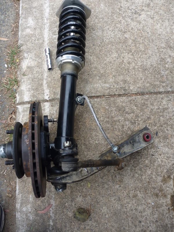

    Next, I pulled my coilovers out of the KE70, and fitted them up. The coilovers are from TRD in Japan, with TRD 8kg springs, Cusco camber tops and Japanese DG-5 inserts....
    Then fitted up the engine crossmember and caster rods and brackets, and a Whiteline 24mm fully adjustable swaybar.
    Next I had the fun job of packing the brand new wheel bearings, swapping Civic rotors onto AE86 hubs (for my RX7 brake kit), fitting up brand new braided brake lines and fitting up hub and rotors......
    Some goodies. XT130 LCAS, New ball joints, New wheel bearings, AJPS caliper bracket, PS arms

    The Lowball King! john84ie's Avatar
    Compton
    1,290
    This shit is gunna be good! I want a spin in the drivers seat when ya finished, I forgot to tell ya that was included in the deal! Lol

    Veteran anastasios's Avatar
    Taz
    Earlwood
    1,030
    wow! where and how did you get the TRD coilovers? are they original TRD sleeves and collars?
