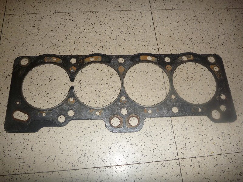

    As "Azz" has said above, sounds like a HG blow between two cyls. Has actually happened to me before, with simular symptoms....
    Ie; This -
