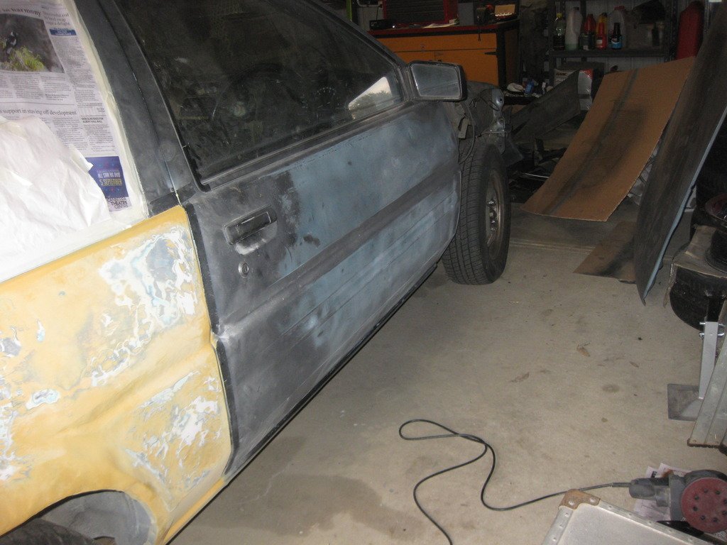

    $800 was a cheap quote I gave you dude......
    Should have done that, rather than now having the bog and bits fall out and having to do it again
  3. #63
    Noooob
    Campbelltown
    5,248

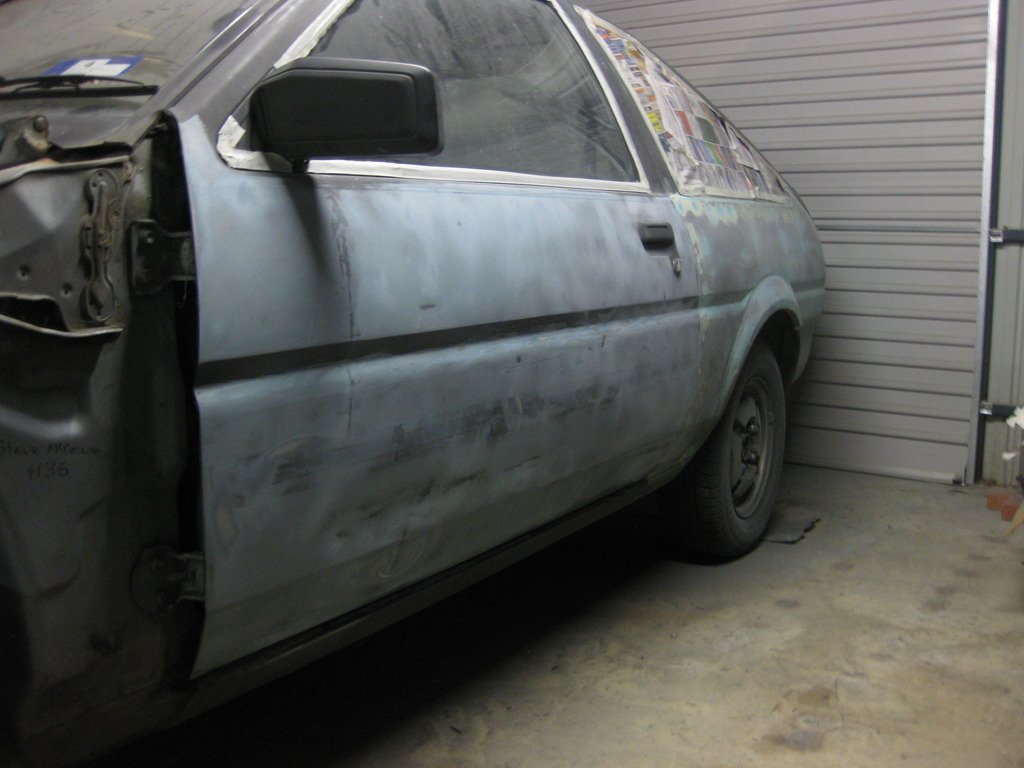

    take the bog off and beat it a bit straighter than that...
    Wire brush removes it in no time. Use a plank of wood to push it so it doesn't stretch the metal too much for the big dents and a hammer / spoons for the smaller ones. Get it close then skim it with bog.

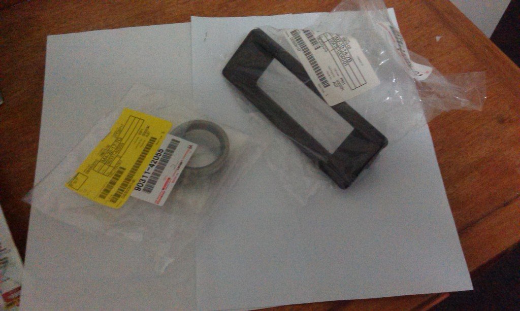

    my axle seals and clock surround arrived

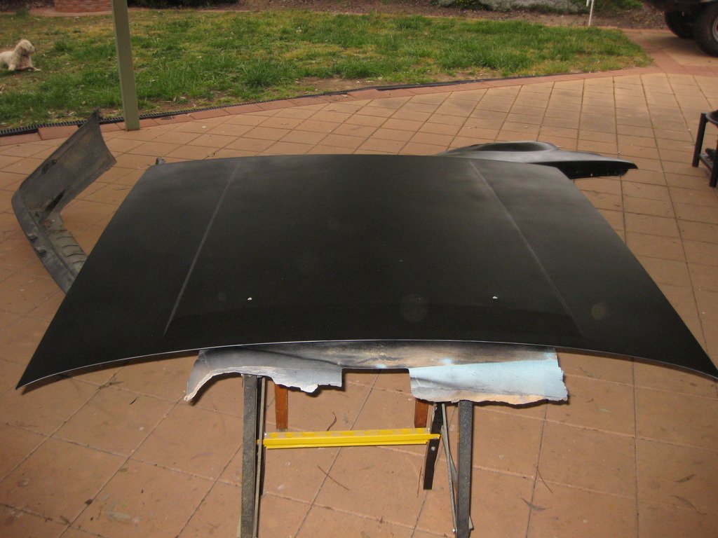

    Started grinding back the paint on the bonnet, uncovered a fair few minor rust spots, but nothing the grinder couldnt get rid of

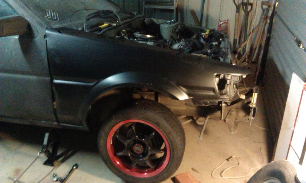

    Not much has been happening the last month or so, picked up a hilux so ive been working on that, however i have done a few things here and there.

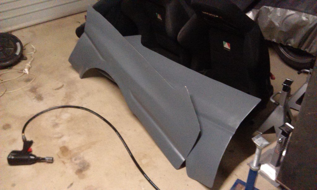

    Picked up a new set of overfenders:
    Will put these on as soon as i clean up the rear quarter panels.
    Been playing around with the motor, it still leaks like a sieve but im slowing cleaning it up to get it through rego. Also currently have the tank out and there is ALOT of sediment in it, so its going to get cleaned out, unfortunately id just put 8 liters of new fuel in it before i decided i should probably should clean out the old fuel thats been in there for well over a few years.
    Also did a bit of a mock up with my wheels and choice of colour to see how it would look, picture isnt the best and everything was dusty when i took it, but i think it will really look good when its all done!
    Getting there...very slowly!

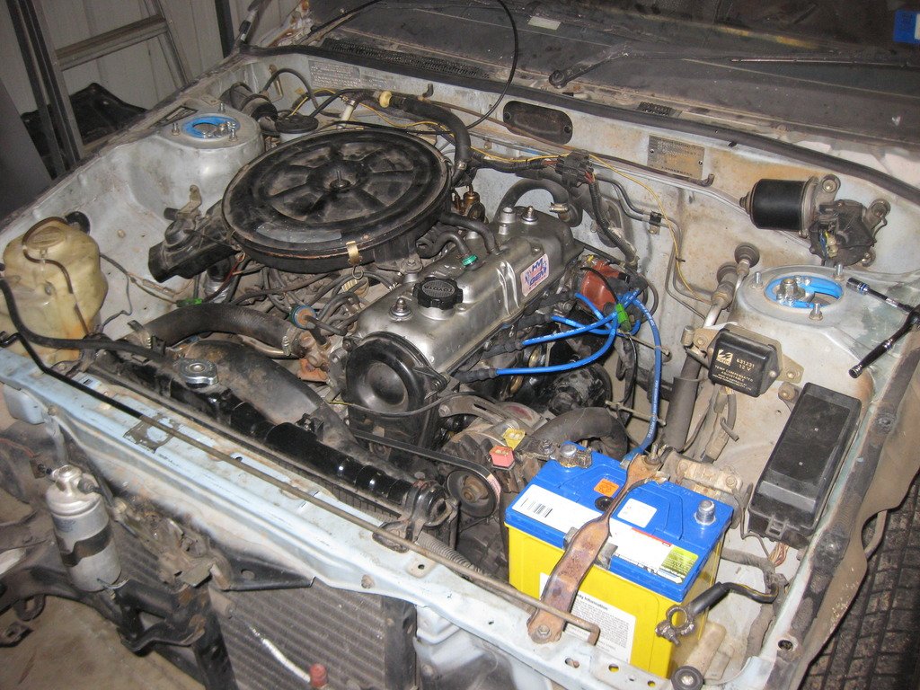

    A fair bit has gone on the last couple of weeks, had a whole bunch of parts arrive so things have picked up a bit. Starting with the motor, because everybody loves a good 4ac story Bought new leads, plugs, rocker cover gasket, dizzy o-ring, dizzy rotor, dizzy cap, battery and slave cylinder as which have been installed minus the slave cylinder. Also pulled out the fuel pump and cleaned it up then re-sealed it to the head. Pretty sure it was the cause of major leak number 3! with the dizzy o-ring fixing major leak number 2. Trying to get the timing/ignition right as of the moment, once its set up properly i should be done with the motor for now.

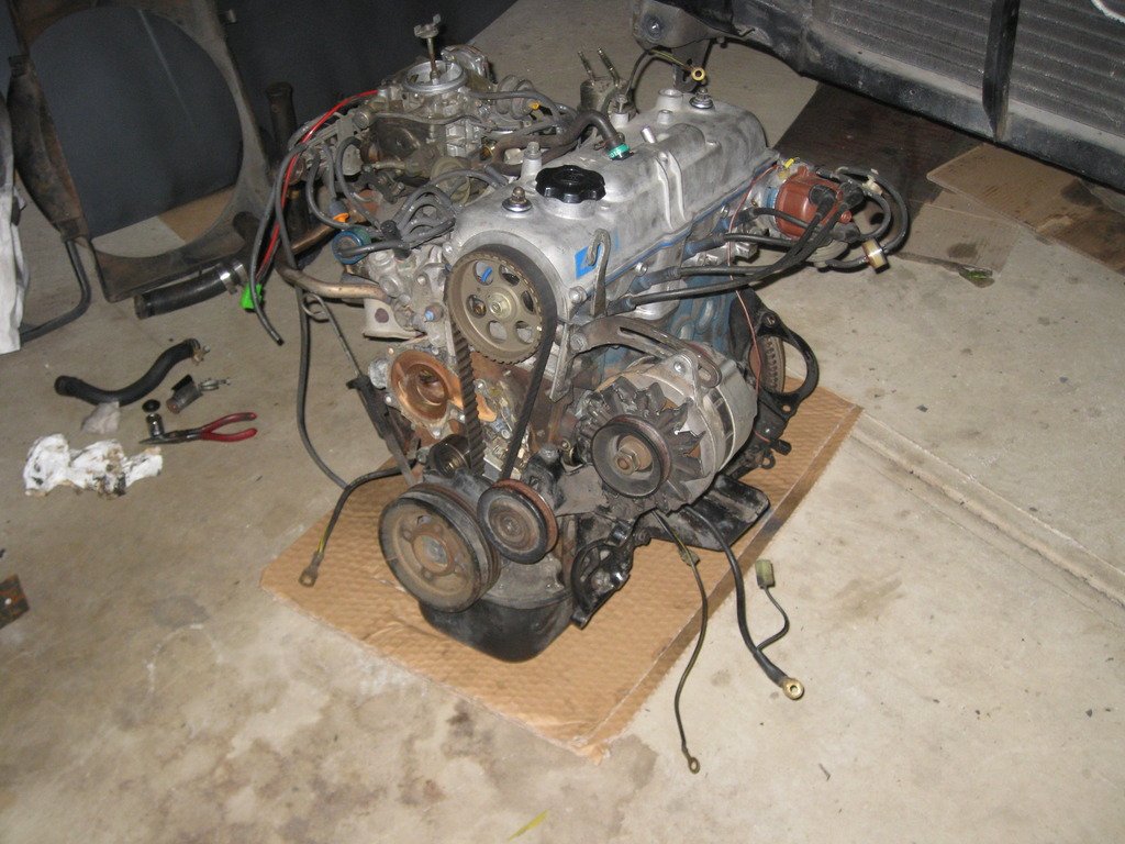

    New motor before it went in

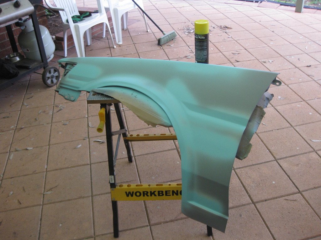

    Sanding continues, finished the whole shell, 120/180 grit on the orbital sander then 240 grit by hand before primer.
    Didn't really take many pictures after that, but it got primer, base coat then clear. Here is how it is now, very dusty but should get it out of the shed tomorrow to give it a clean and buff.
    RH quarter still needs a bit of touching up to have hopes to pass rego. Otherwise the rattle can job turned out ok, bonnet and roof look abit sketchy though, but it will do for now. Also picked up a strut brace which is fitted, camber tops have been adjusted for street driving too. Looking to get two tyres this week for the enkeis to be fitted to the front and then hoping to get some AJPS street springs to drop it down a bit.
