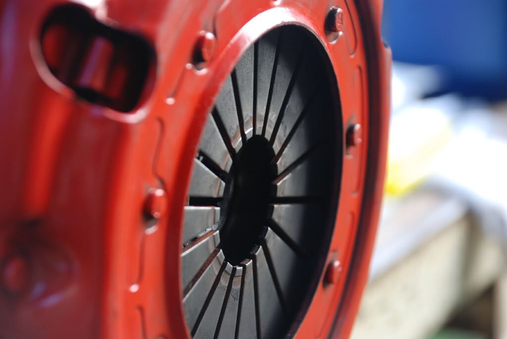

    Firstly, the pressure plate is not the exedy one that should have been supplied with the kit. It is a PBR item with significant wear to the fingers.

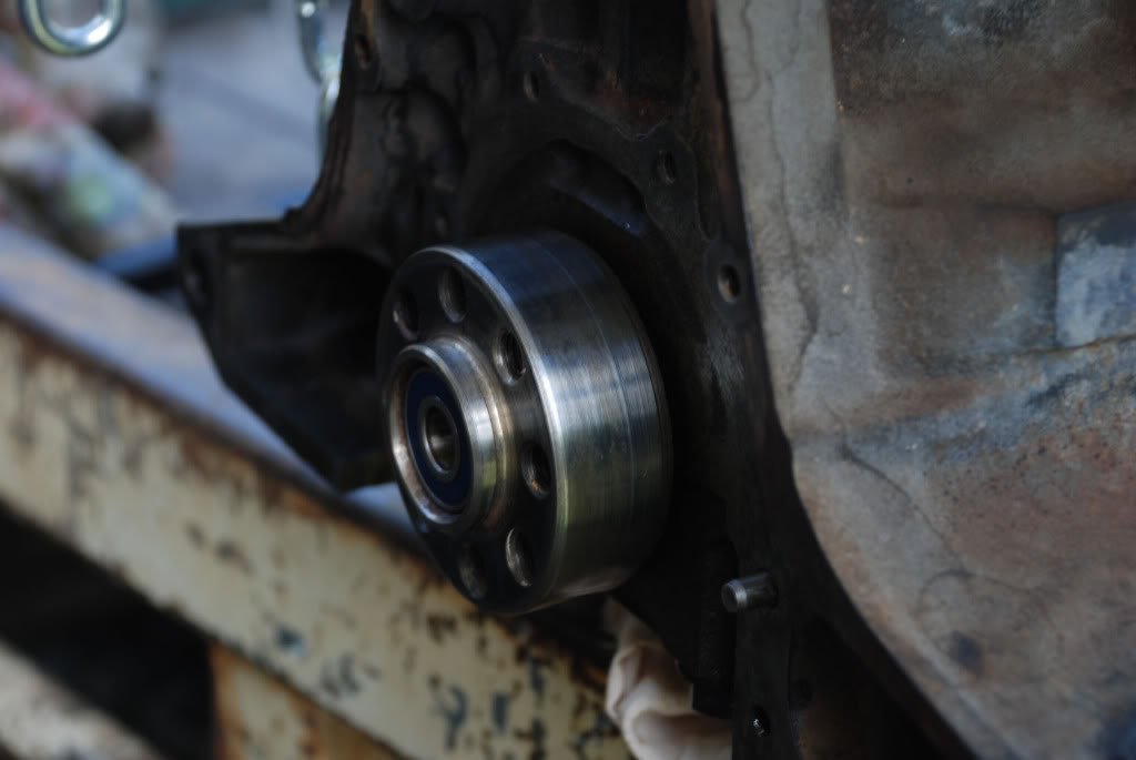

    The spigot/pilot bearing is crunchy, though moves better if pressed downwards very hard.
    Along with other major leaks, the rear main seal is the reason we decided to pull the engine. Its always leaked, but has gotten worse this year. The seal we replaced yesterday was very soft and the edge was worn flat.
    There was a slight groove in the surface of the crankshaft that we smoothed out.
