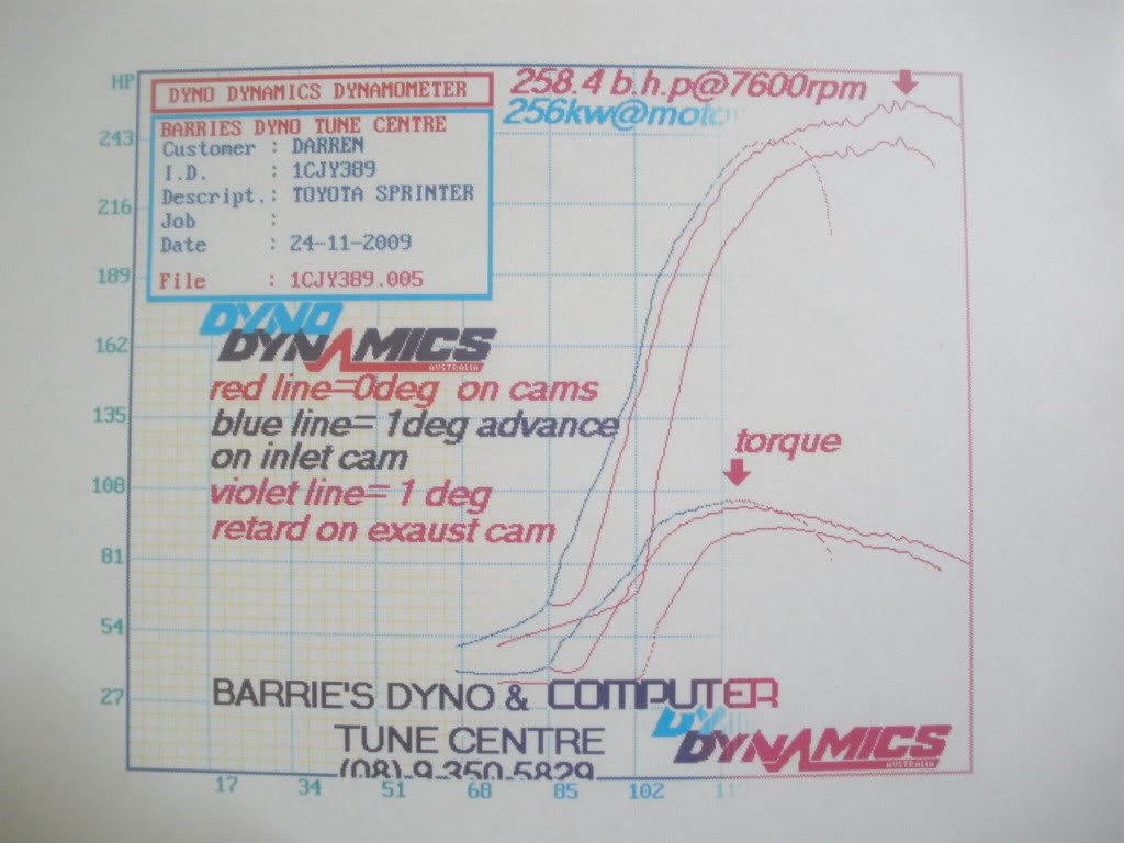

    thats the newest. also lopped my cannon off an got a 3 inch super cat muffler on it now, its a straight through but is nice and quiet in the car now...

    Thats impressive Dazz. You must be happy.
    The BHP to KW's seems strange though. I though KW's was roughly 2/3's HP?

    i think its 256kw at motor. I wouldn't mind aiming for that with mine
    1hp=.75kw

    so what is it at the wheels?...massive power regardless =p

    yeah 258.4hp at the wheels. yeah was a good little increase. used to sit at -20mmhg vacuume at idle before, so now it sits on about -10 with the cams. so halfway to boost at idle. Loud exhaust was givin me the shits, so got a 3 inch straight through super cat. muffles nice but no loss of power. Just enjoying it now....

    its not that its "halfway to boost at idle" , its because of the overlap of the cams due to their duration and where they have been set to that the motor will not pull as much vacuum as before. mine does the same.
