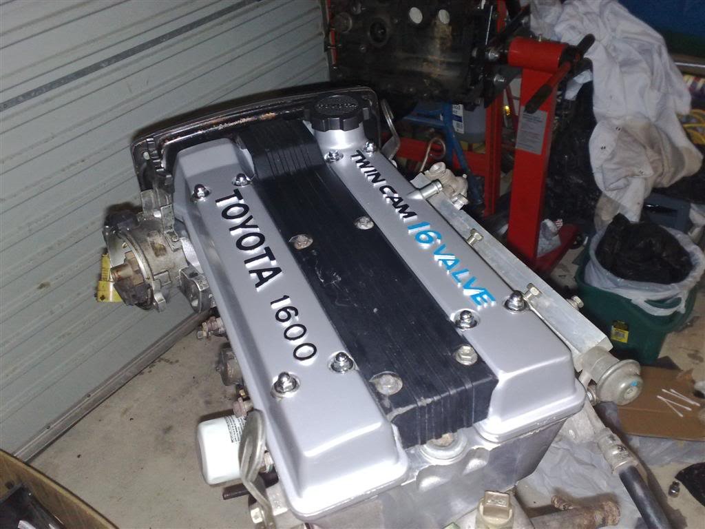

    dont hit it with a wire brush!! u will scratch the crap out of it!! your better off to hit it with some paint stripper, then sand it with some wet n dry.
    u want them looking new but u dont want to paint them? it will take you all of half an hour to prep and paint them!.
    if u want the writing a different colour, paint the letters 1st, then let it dry, then place masking tape over the letters, then get a stanley knife blade and cut around the letter edges, once done, spray the rest of the rocker cover, then peel the tape off the letters,
    it will be worth it and it will look sick!

    crinkle black with silver writing ftw. doing mine this week too. just sand them back to metal, whack some etch primer, then sand, then normal primer, then sand, then paint. dry. bolt on. la fin.

    heat proof. it limits your choices of colour, but the finish will stay nicer for longer. maybe the heatproof stuff has built in primer? now i think about it it might.

    Don't have to use tape to mask out the letters, just use some grease on a cotton tip.
    I used wire wheel on mine, does not come up scratched at all after painting with VHT enamel.
