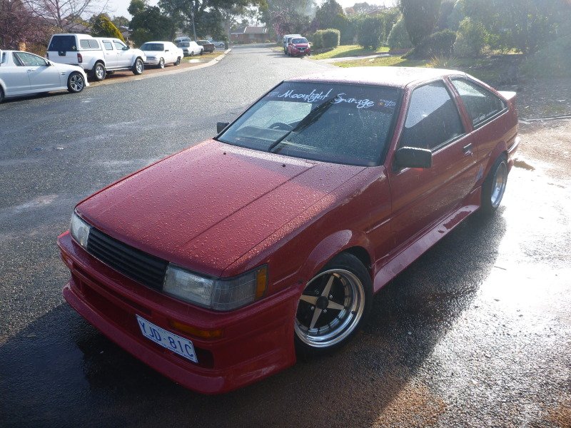

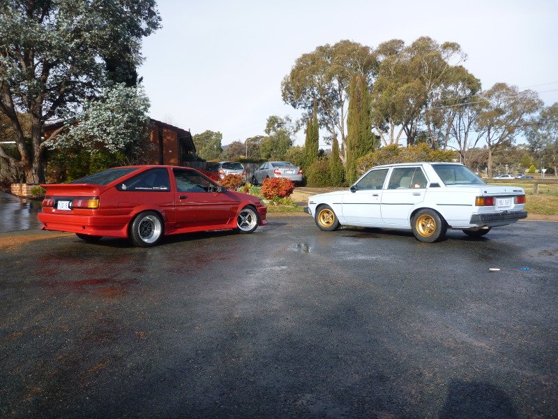

    After having an accident (write-off) in my previous Gold AE86 driftcar, this time I have bought a built AE86, it was a workshop built car, and was built 2011 - Feb 2012. Usually I build my cars myself myself, so this was not something I would usually do, but I found something nice and was the right price. Most of the work had been done. I was left to tidy up the little things and to make things to my liking.
    After working a 14hr shift all night, I went straight to the airport at 5:30am, flew from Canberra to Brisbane and back today, to buy it and drop it off at the trucking yard.... Feeling haggard now, but its now mine and on the way

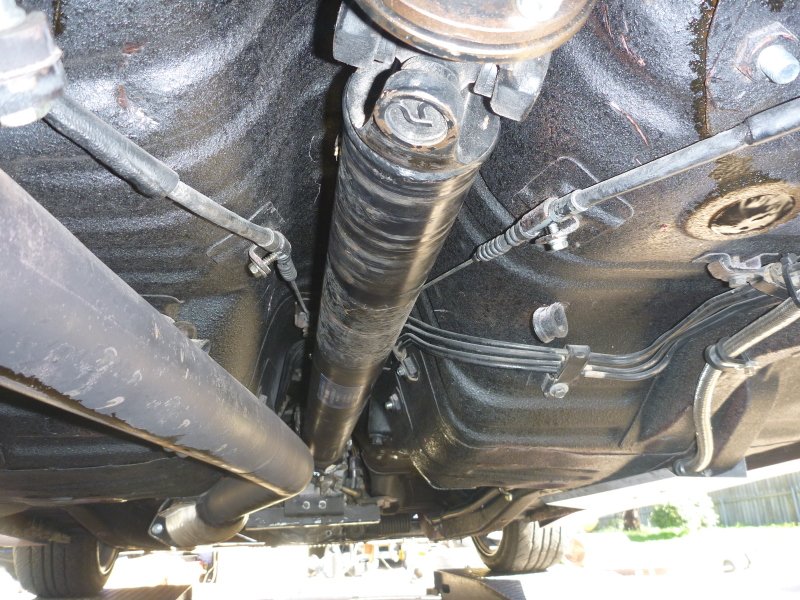

    Single piece custom tailshaft
    Modified to suit AE86 BW78 diff (Borgwarner). VS Commodore housing, custom BILLET axles and 4x114.3 stud pattern, VS rear custom dual calliper brakes.

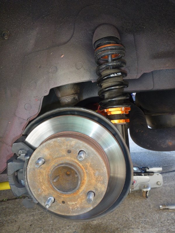

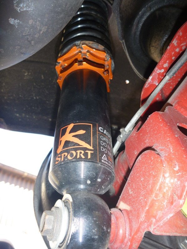

    GReddy Type S coilovers Front - 8kg (New Sept 2012)
    GReddy rear suspension (Type-S kit. Adjustable spring perches with 6kg springs and 32 way adjustable GReddy shocks)

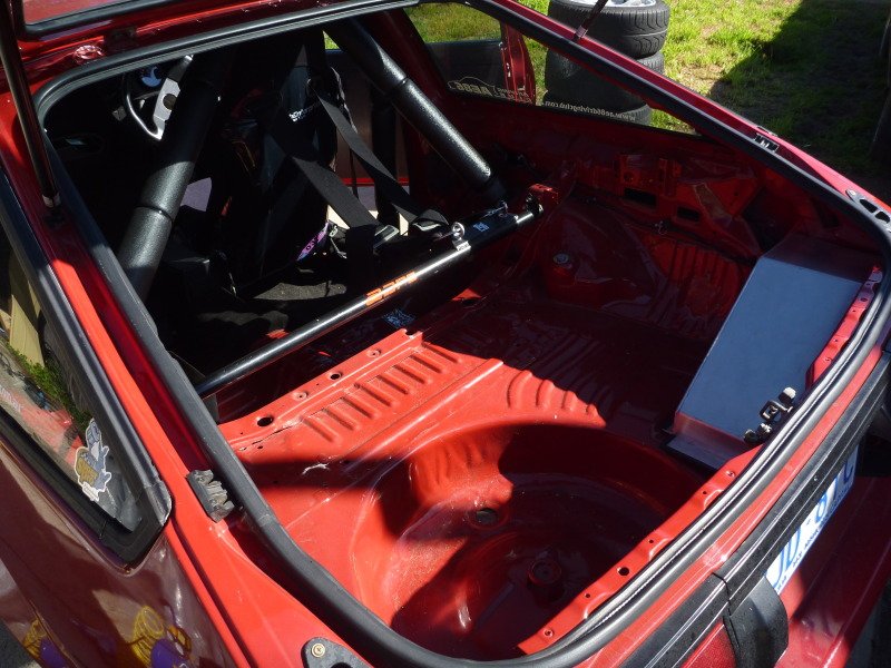

    Whiteline Strut brace front and AJPS rear brace with harness mounts

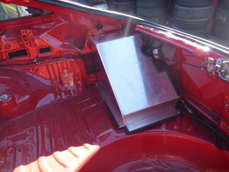

    "ARE" Surge tank in boot with custom aluminium cover

    RPM 3" 5 point Harness
    Genuine 'Personal' steering wheel
    Cusco?? full bolt in cage (front legs not currently attached)
