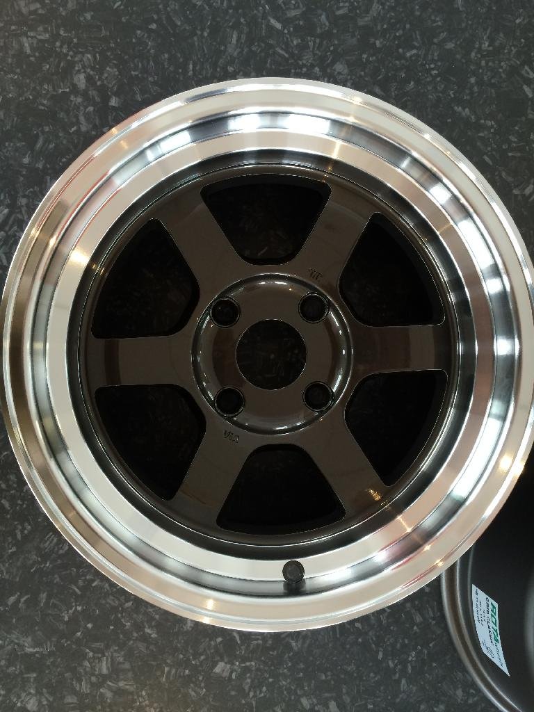

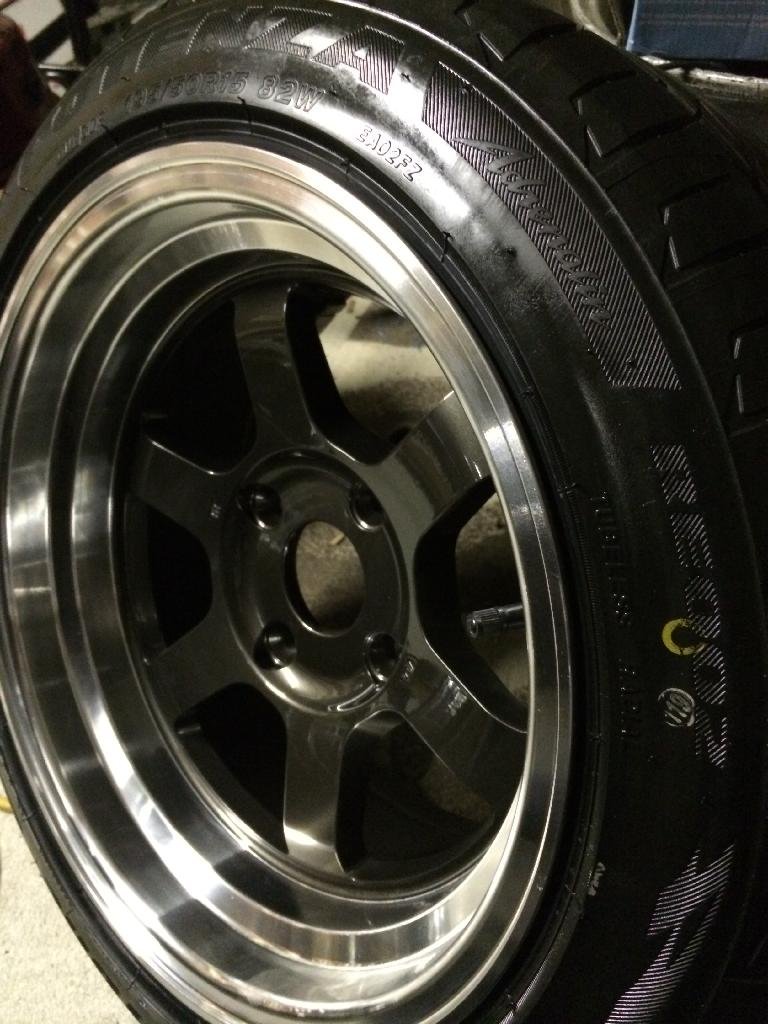

    Needed some cheap steerers that would fit over my brakes as unfortunately my XR4s are 14" and my meshies don't have enough 'X-factor' (apparently that is the correct term for the spokes moving back out from the point of connection with the hub).
    Tom had some wheels that I could test fit to ensure they had the correct clearances and in the end I bought a pair of these:
    in 15x8 zero offset (They are Grid classics)
    BTW apparently small sized performance tyres are even harder to come by west of the bight (first place I called told me it would be an 8 week wait!!!!)
    But in the end I managed to track down a pair of RE002's that were the only two that Bridgestone had in stock in WA (in a 195/50/15 anyway)...

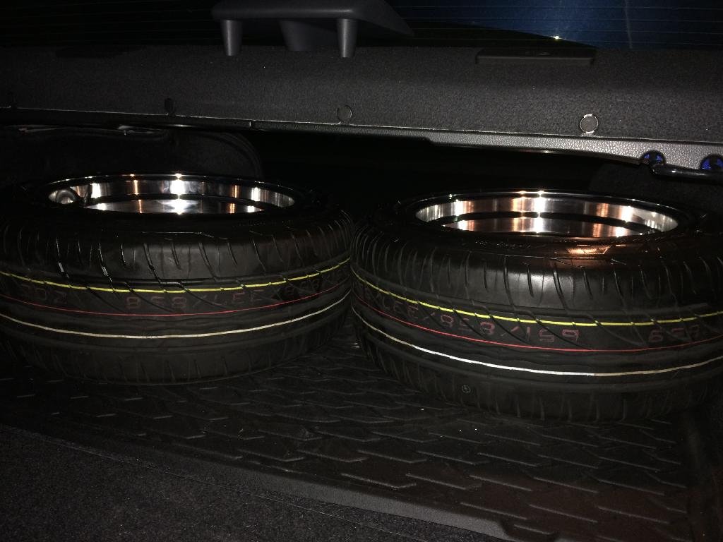

    PS, you can fit 2 wheels with tyres in the boot of a ZN6 (and there is still a spare under the floor ) (also can't see it in the photo but the boot closed with the rear seat in the normal position)

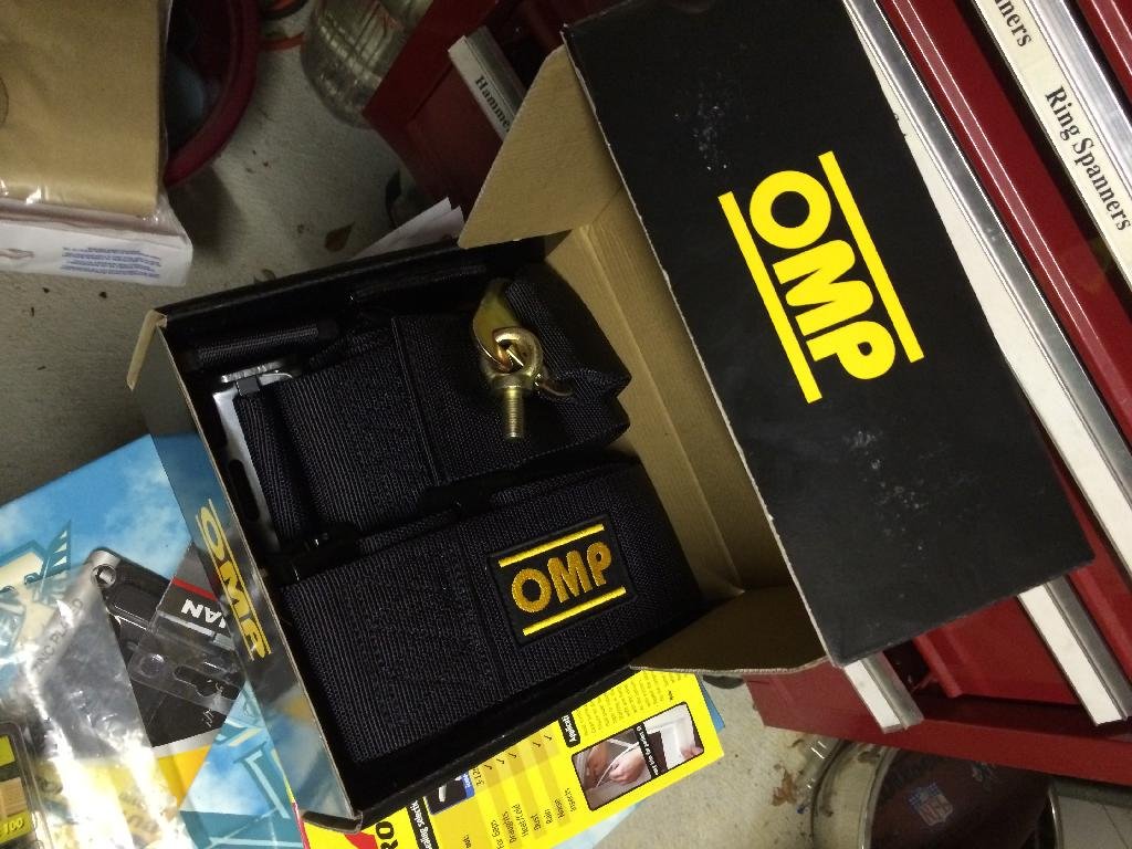

    I also stopped by and picked up a harness today for the driver's seat because, all things going well this thing will be able to move under its own power by the end of the weekend

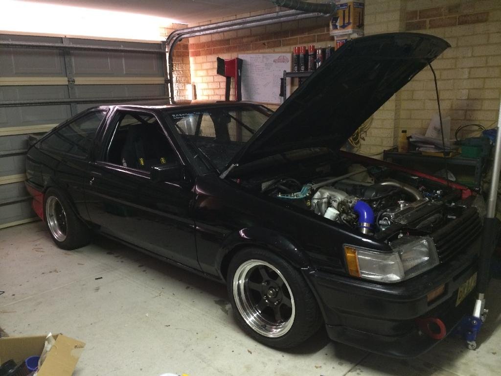

    Over the (long) weekend I:
    Fitted the new rear brake caliper adapters and then actual brakes
    connected the drive shaft
    filled diff and gearbox with oil
    finished wiring for the remote warning light
    removed and reinstalled the dash to fix problem with the CEL (fun)
    finished wiring for thermofans
    installed override switch for the thermos
    fitted harness bar
    fitted harness
    installed short shift kit and shifter
    Hooked up reverse lights
    made up restricted gasket for the dump pipe (metal with a couple of small holes, didn't want to ruin my brand new gasket for the dump)
    reinstalled some of the trim around dash etc
    adjusted handbrake
    fabricated mounts for the overflow bottle and catch can and fitted them both
    Went around the car and tightened a whole bunch of stuff to make sure nothing had been left hand-tight over the past 18 months and forgotten about
    fitted wheels
    Test run through gears while car was up on stands
    Lowered car and test drove
    realised the alignment was terrible and made it a little better
    More wiring
    Fitted bonnet
    Fitted strut brace
    and to be honest heaps of other stuff that I won't bother giving blow-by-blow on
    All up a pretty successful weekend.

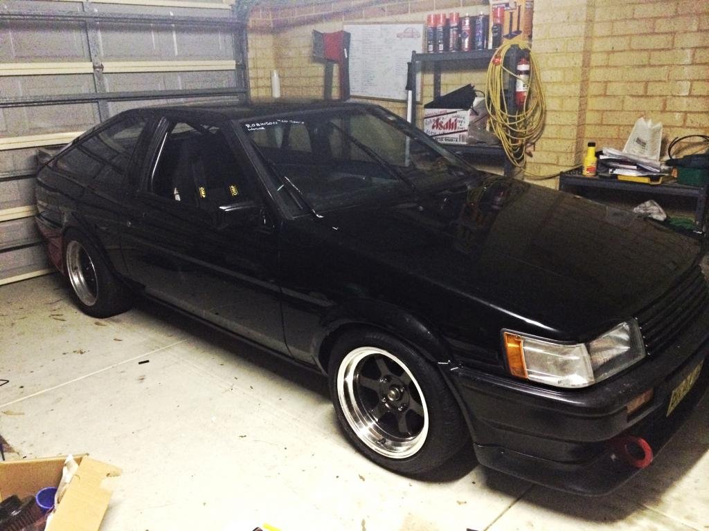

    I have tentatively booked the car in to get the exhaust fitted on Tuesday (next week) and am seeing if I can organise a tune by the end of that week. If so, I will try and sort an alignment and wear in the diff as well. If all that comes to fruition then there is a chance I will be able to enter a motokhana on Star wars day...
    We'll see, but I would be surprised if everything goes that smoothly...
    Either way, no more pushing the damn thing
    P.S. This much dust means your project is taking too f$^&ing long...
    Current Cars:
    Paul
    266
    It must have been the weekend for it Robbo, I managed the drive the KE up and down the road on the weekend as well. Still some teething problems with the suspension that Chris is helping me work through and a water pump that decided to drop it's guts but other than that I should be good to go soon. Managed to find some RE001 for the 14" rims that came with the car for daily duties so just got some DZ03 fitted to the 15" rims for that day that I finally get back out on the track. All in all I am looking forward to getting the thing back on the road and driving it.
    Can't wait to see some footage of yours in action.
    Veteran ae8zn6's Avatar
    Robbo
    Gippsland
    1,036
    Good to hear you had yours going for a little while before the water pump packed it in
    Getting the Exhaust fitted tomorrow and if I have time I will do the Alignment and diff wear in procedure too.
    Either way I should manage to get it all done before the tune which is booked in for Friday evening
    So, it is currently still looking possible to make the Motorkhana on Sunday (So you might not have to wait too long Paul)
    Having said that I still expect that I will run into my own teething issues before the car gets out for its first event, there has just been too many things done to the car over such a long period to get away with no issues
    I guess we'll just have to wait and see...
    In the mean time, it looks like a semi-normal car again:
