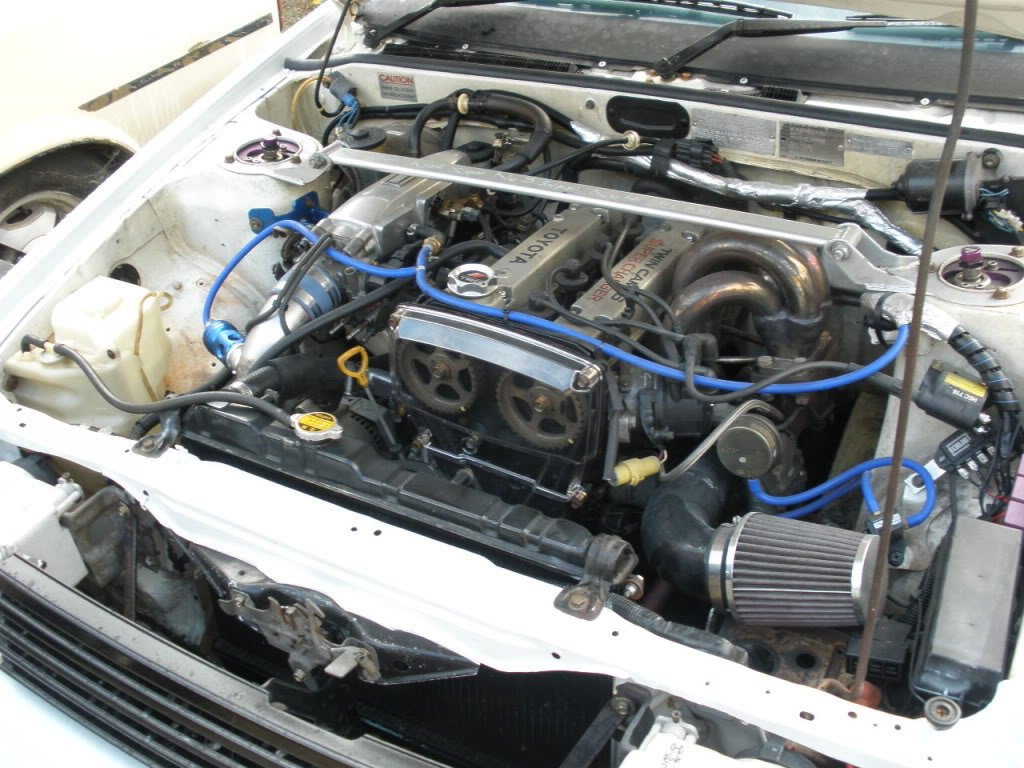

    Current engine
    AW11 MR2 4agze
    Wolf 3D version 3
    China manifold
    RB30 front housing, RB20 rear housing turbo
    3inch exhaust under diff, 1 muffler
    Greddy boost controller
    GFB BOV
    550cc injectors toyota items
    256 8.35mm inlet, 264 exhaust 8.35mm exhaust cam both HKS items
    adjustable vernier cam gears
    cusco engine mounts

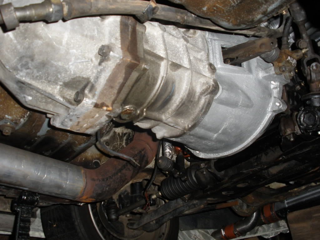

    Drivetrain
    W58
    bellhousing i got while on holiday in phillipines
    3" one piece tailshaft
    4 puck excedy w/4a custom clutch
    F series YR22 diff 3.9, AE86 mounts
    MA61 truetrac torsion centre

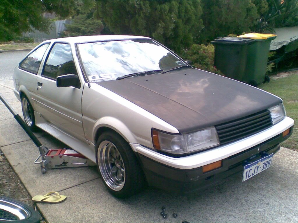

    started off like this

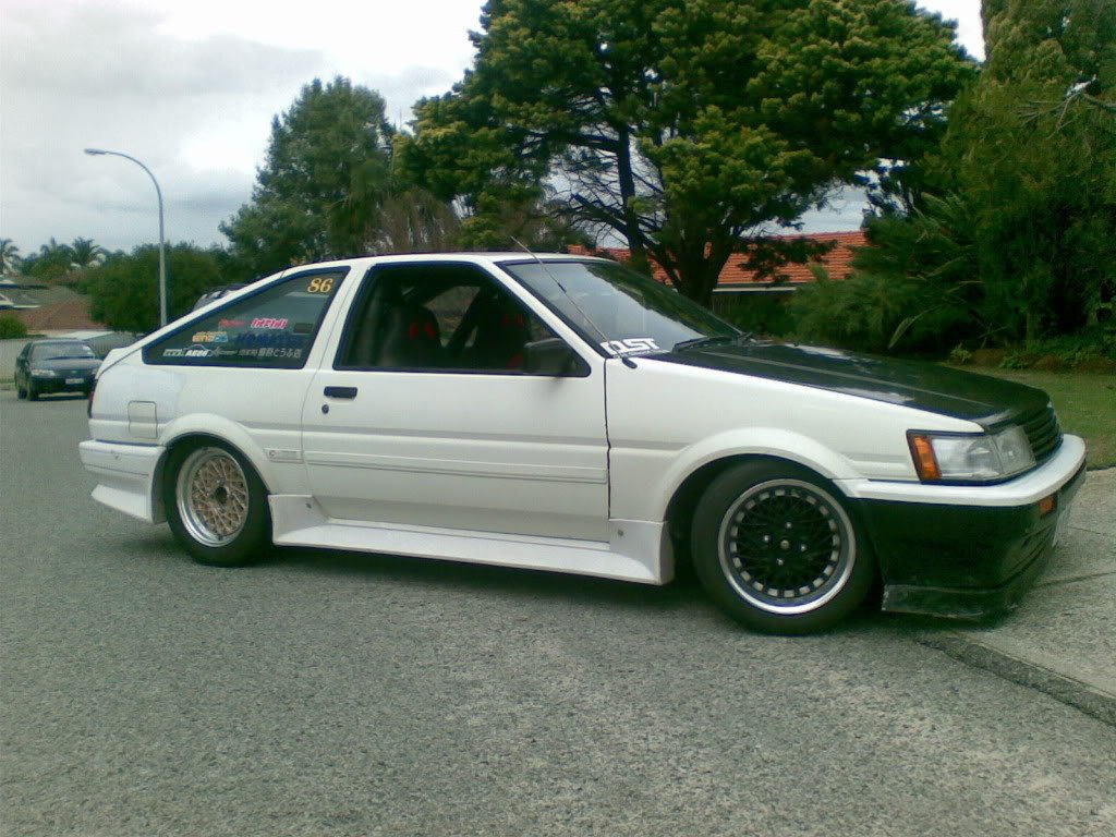

    found what style i like the look of after toyin with heaps of different rims an parts

    So i pulled it all out again, an went bigger an better with a gze this time, also with a big darty W58
