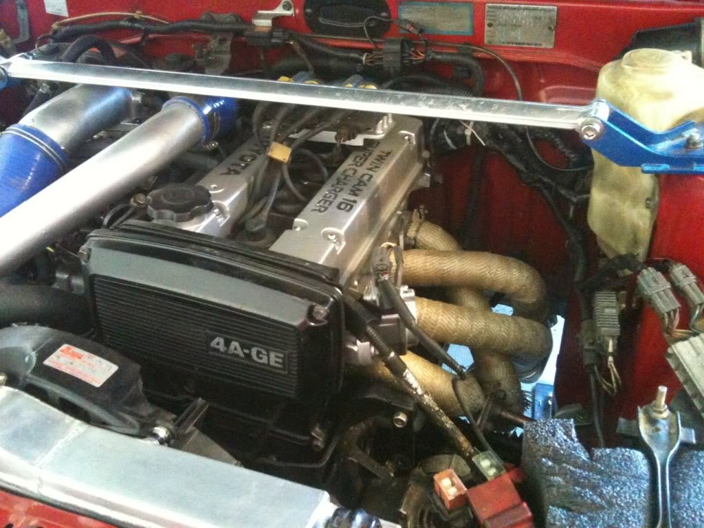

    I had some issues with running out of electricity, so I swapped over the alternator and as an extra precaution decided to heat-wrap the exhaust headers:

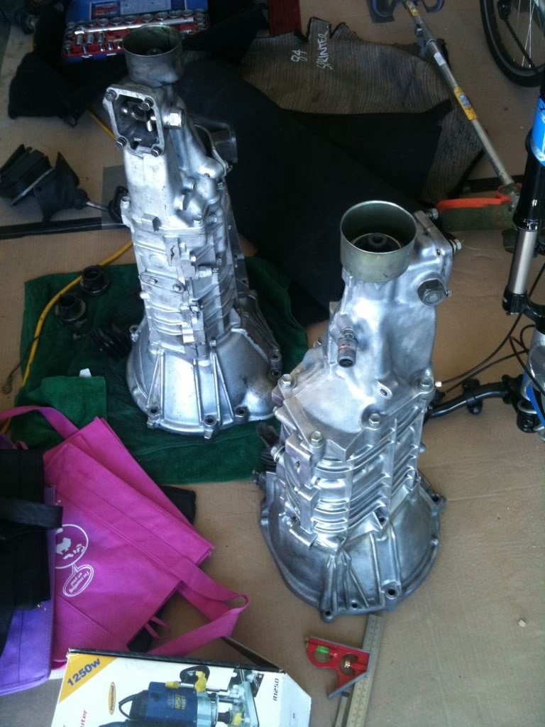

    Also from driving it a bit I noticed an oil leak coming from the gearbox into the bellhousing... lame... anyway, so I pulled it out, decided I would clean up my old adm one and put it in then possibly reseal the JDM one while it was out, but of course I needed to use the JDM bellhousing due to the clutch salve being on the driver’s side:
    Note: that’s cleaned, not painted...
    Both boxes:
    I know, I know, I didn’t need to clean them, waste of time, etc etc... Keep in mind, I was addressing an oil leak and wanted to know if the thing was still leaking...

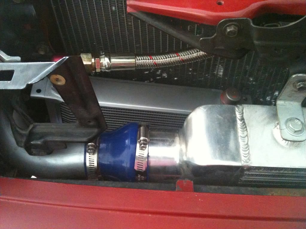

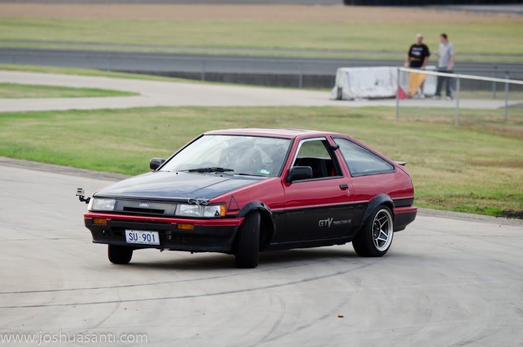

    While the box was out I decided to change racks to give me more lock as it turns out the GTV manual rack is a 3 turn lock to lock jobby (vice 3.5 turns) that is slightly shorter (less total lock). And while there might be some haters out there I can say there was a massive improvement in steering authority! At the skidpan thingy a while ago I found I was spinning a bit because I was driving the car how I drove the old car and with the shorter rack I simply couldn’t sustain the same angle... I also tried to fit a remote oil filter/cooler kit, but did that without removing the exhaust etc, which meant it leaked, so I removed it for the time being as I didn’t have a new exhaust gasket.
    Anyway, it turns out the gearbox leak was coming from the bellhousing seal, so the leak didn’t go away when I changed boxes, but instead got worse... (removing/reinserting shafts etc) And of course I found this out 3 days before the event I had been changing shite over for (driftmob peanut drift night) So, it turned out it was good I had planned to completely reseal the JDM box, because I had ordered a t50 seal kit and it had arrived in time to fix the bellhousing in the time I had left...

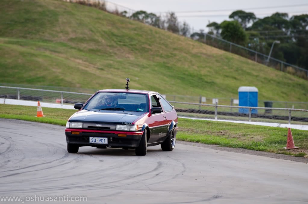

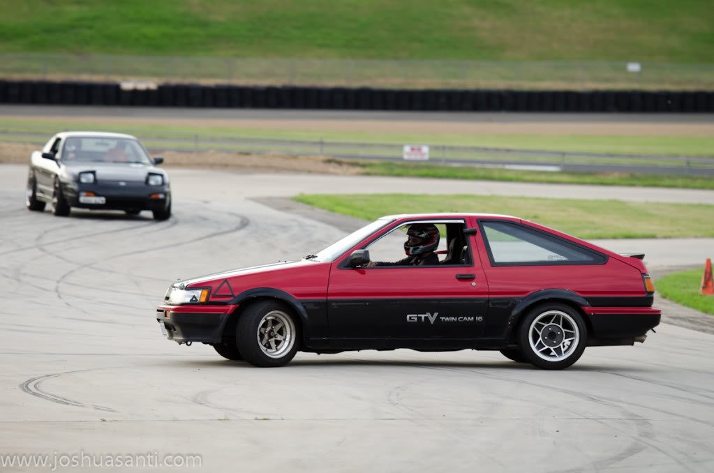

    Anyway, so I then managed to get work to let me off early on Saturday so I could go to the peanut track and have a go at the sideways thing again... To be honest I was pretty average, but I had a good time, and the car held up pretty well, although I probably need a bit more power to keep my reasonable quality 195s spinning on the back (still running stock boost/motor). Well, actually, I could keep them spinning, but wasn’t getting any bake at all, which makes me sad...
    Anyway, pics:
    Anyway, so that was good fun, long time till they have another one though, so I have a little time to get a few other things sorted (like that oil cooler). Hopefully next time there might be a few other hachi boys in the field too.
